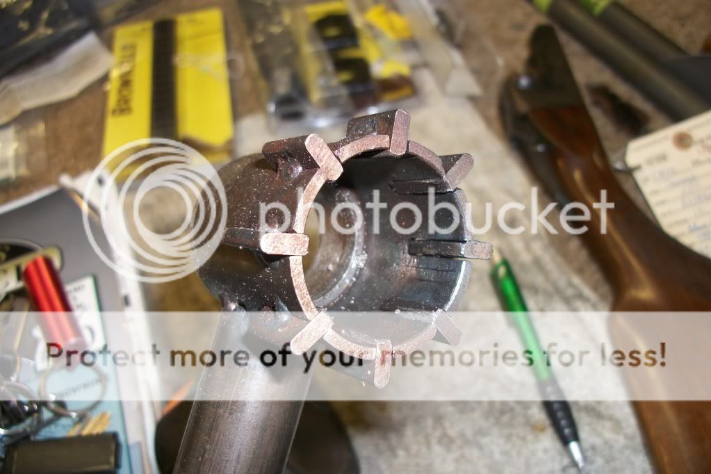

Can someone make this for me?
I have 2 Eliseo RTS chassis that I use for FTR one with a Nesika action in 308 and the other with a Remington action in 223. I have a 30" Benchmark barrel on the 223 chambered with a shoulder, but I would like the option of using a Rem/age barrel for either a shorter 223 barrel or a 6mm-223. Here lies the problem. The action sleeve of the Eliseo chassis extends far enough past the action face that you cannot get a barrel nut wrench onto the barrel nut. I was dreaming up ideas of how to make a barrel nut wrench that would fit down into the action sleeve to engage the nut and this is EXACTLY what I was thinking of. Seems that someone else had the same idea as me for a wrench. So, can anyone make something like this for me? It does not have to be pretty, just functional, and I would of course be willing to pay for your time and materials.
What are the dimensions of the various components? I'm capable of making that. And I can heat-treat it if necessary for a stupidly strong version of that. Let me know..
Thanks Jason, I had another member contact me and offer to machine one from a solid piece of 4140. I don't have the dimension off of the one above. All dims would have to be taken off of the nut itself.
If they are capable of machining that from one piece of 4140, then you should definitely do that. I don't have the tooling to make that from one piece unfortunately.
