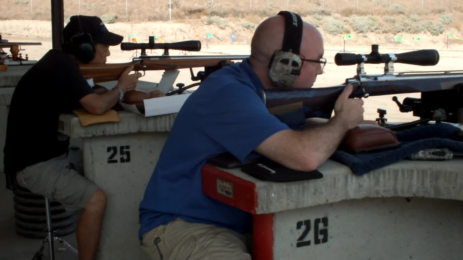

This scope is a specialized item for short range group benchrest. The modification was probably done by Ron Hoehn. One year, long ago all of the members of the US teams that went to the World Benchrest Championship shot those scopes with that modification. The set screw on the bottom is not really a problem because competitors use very tall rings in that sport, which makes for a more upright position at the bench which is better for observing flags. Also, in many cases, they want to minimize their contact with the comb of the stock. Here is video I took back in 2017 at a match in Visalia, CA. Note the scope heights.
