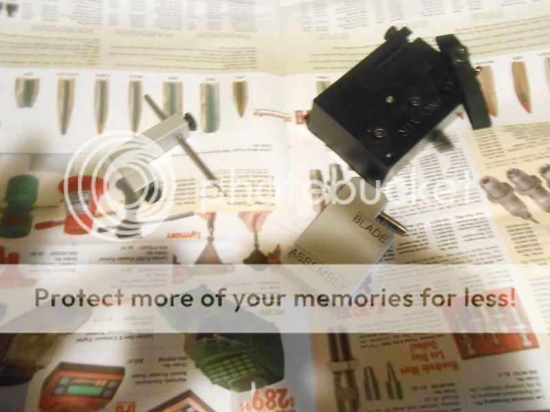

I have the L shaped piece shown on the stand in this link. I got it in a neck turning tool lot I bought some time back.

Is what I have just a part of the neck sorting tool shown above , or was it sold separately ? Can the tool pictured be broken down to remove it from the stand? Can I use it without the stand, and lastly is this an acceptable method of measuring neck thickness?

The picture is just to show what I'm inquiring about. What I'm referring to is just the L shaped silver part that sits on top of that. Not sure if it comes off that stand or not, but I don't have the stand. I have the indicator, but no pilots.
The L-shaped aluminum part can be separated from the black anodized aluminum base by removing a couple screws.
What's pictured (link) is just a sorting fixture, minus required dial indicator.
Neck-turning tooling is not shown; several companies can provide suitable items depending on your needs and budget.
I assume this stuff is a bit dated. My L shaped piece has no holes to attach it to anything, and it's a solid machined part. Perhaps the tool was first sold without a stand? I 'll post a pic of it when the host lets me. Would it be any better at measuring neck thickness than a caliper? If not, there's no sense in me buying pilots for it. I have a neck turning adjustment fixture and the correct dial for it, but my trimmer won't attach to it. Just trying to make sense of what I have here, and if it's worth adding too.
Yep, you have their early neck-turning tool (larger item at right) which with the proper mandrel and cutting tip can do a serviceable job. If you have the adjusting gauge too, so much the better!
The other item's a wall thickness fixture; stem accepts adapters for various case neck diameters, the free end fits case flash hole to keep cases centered. What you'd need would be adapter(s) and dial indicator.
Yes, I have the indicator with the little finger thingy for the adjustment fixture, and the screws to attach a trimmer to the fixture. Bummer is... I'll need to buy the newer style trimmer to use it. I have mandrels for .22 up to .338, and I'm assuming will those work with the newer style Sinclair trimmer as well.
