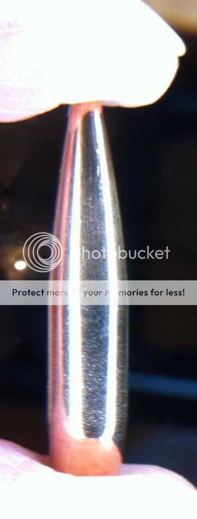

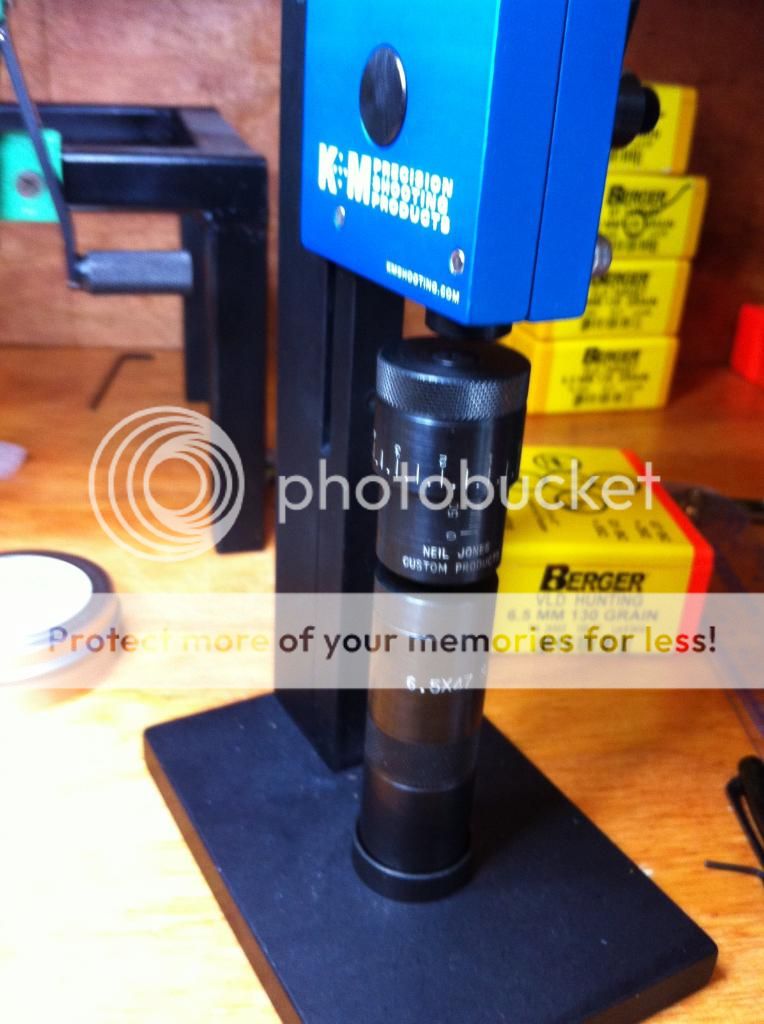

Using feedback from 22BRG44 and Dmoran above, I did a little test this afternoon. I used a previously fired (5 times) Lapua 6.5x47 case (its in good shape) I prepped it as usual: used Neil Jones FL case die on the case, then then ran a nylon brush once through the case neck to clean it. This case already has a chamfered neck mouth inside and out since I did this the first time I used the case; the inside chamfer angle is about 13 degrees, pretty acute, I measured it. I then used a Neil Jones seating die (made for these 6.5x47 rounds) and a KM arbor press to seat the bullet as usual. In pic #2 (the following post) you can see small scratches at the pressure band on the extracted bullet just above the boattail - these scratches were not evenly distributed around the circumference of the bullet (which is maybe a possible concern?).

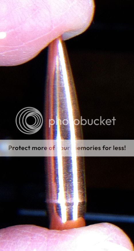

Using the same case, I used 22BRG44's suggestion and pressed/rotated the mouth of the case neck against 0000 steel wool to smooth out the neck mouth, and also used Dmoran's suggestion (above) and wrapped a small piece of 0000 steel wool around a Q-tip and gently rubbed (spun) it against the overall inside surface of the case neck. I could see the inside surface was cleaner. Then I seated a new bullet in the case in the same manner, extracted the bullet, and took a pic (pic #3, in following post). Using these last two approaches there were no scratches at all anywhere on the extracted bullet. 22GRG44's and Dmoran's method seems to work. I don't know if it will have any influence on POI precision because the scratches are small, but given the small differences we want in precision at distance and the 175K spin on these bullets, it might.
I will try to attach pics #1, #2 and #3 in the following 3 posts. I have cropped these pics to make them less than the 150 kb limit per pic, but don't now how large each cropped pic file is - I will try.

Cassidy: Sounds like some thorough research you are doing. Pictures would be nice, I use Irfanview software and reduce the size of my pictures for posting without a problem. Can easily get them down to 55 to 58 size.

You can refer to these copies of your pictures in a following post. I only put up one of the seater and press.
