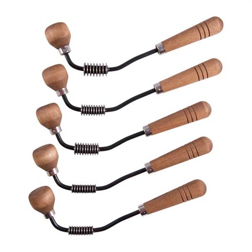

I've used the Gunline Barrel Bedding Tools for faster scrape inletting. These can sometimes roll over the edge and make marks in the top of the stock. Again, be deliberate.
https://www.brownells.com/tools-cleaning/gun-tools/stock-tools/barrel-bedding-tool/

Maybe not from Brownells but I've found them elsewhere. This is a good picture of that tool. They have really gone up in price since I bought mine ages ago but they are an outstanding tool when you practice.
