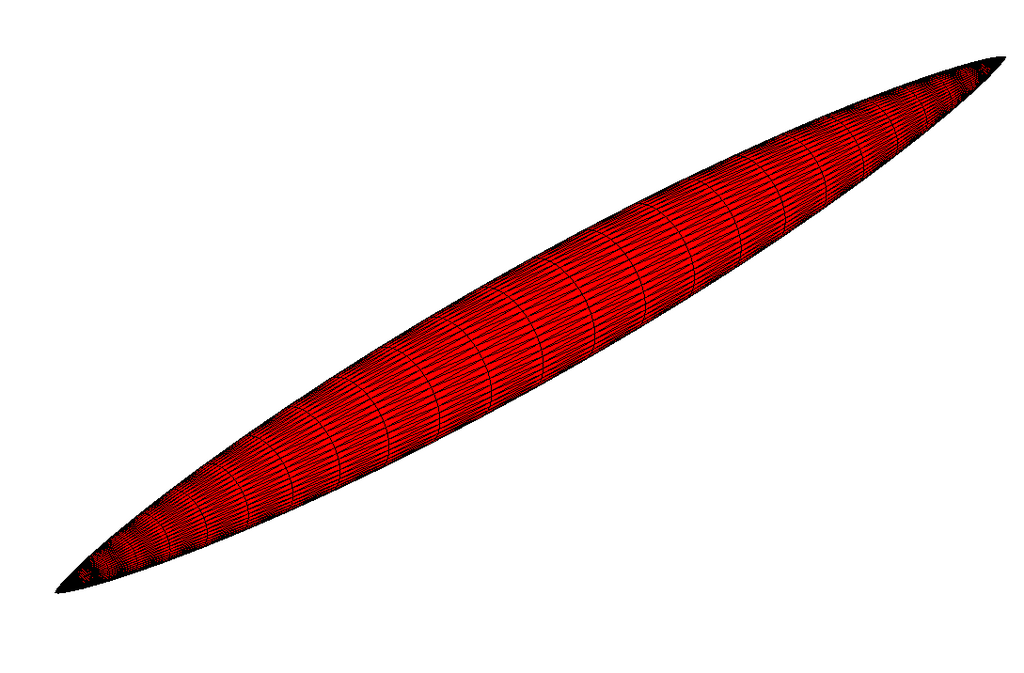

Try soldering together two 1.5" Flat based bullets so you have a point on each end. That would give you a near perfect Sears-Haack body. Theoretically there is no more perfect aerodynamic shape than that.
Unfortunately you may need a case with a really long neck to hold it 8)
That's called a " pushmi-pullyu" bullet. First record of one is from ancient Greece, but it was used for something else then. :o
