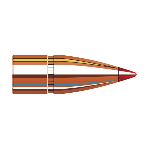

In the data books I have , They give you c.o.a.l. for each bullet. But if you want to find lands ( datum line ) and come off .06 or .010 off lands you can"t seat bullet into neck of case enough to secure bullet . In my setuation , I'm seating a bullet , hornady #3142G into case 7.62x39 and would like
to be .06 to .010 off lands but I can not because if I do I"ll have less then 1/4'' to hold bullet in case.

According to my drawings, the neck length is only 0.225" long in the first place, so your 1/4" is actually fine. This is a VMAX, ZMAX or SST bullet with a cannelure also depending on which company is marketing it:
The 'normal' handling of these bullets is to crimp into the cannelure when shooting in a semi-auto firearm. I have never shot this bullet or that cartridge but according to a couple of buddies, the bullet is more than reasonably accurate and has been used for hunting...

Give us more details. How did you find your lands length? Why and how did you choose a seating depth of .006 to .010 off lands?
my rifle is bolt action 527 CZ 7.62x39,I shoot anumber of different bullets , and I use Hornaday comparator to find my lands,
when doing this I start with .10 thousands off lands but most bullets are shorter or smaller and I think I don't have
enough of bullet into case neck .
