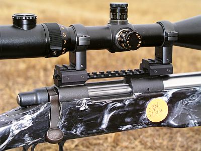

Get the taller ones,High) like in the picture above of Jeff's rifle if you plan on the Weaver style. The medium one's are cut so the relief for the screw goes to high up, into the cutout for the shims and will break. You can take a pair of new mediums and apply pressure with your finger and thumb and they will break! Did it! Seen many of the medium's with a hair line crack in this area. Even tried to expand it to Burris with no luck. All they have to do is shorten the relief cut were the metal squeezes to hold the ring to the base and they could fix this issue.
kodiak,
Is this with the 1", 30mm or both
I know that it happened with the 30mm rings. The 1" rings I have not seen this with but it may also exist.
The issue is that the relief cut for the Weaver style is so close to the convex cut for the shims, there is only about 5 to 10 thou of metal left between the two and you can break a new one with very little pressure.
