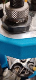

Up until today I've run nothing but pistol on my 550 press. The jumping into the Dillon blue waters thread got me thinking I need to set up for .223 as well. Work was closed due to water issues today, so I thought I'd get a tool head set up for .223 Rem. Got my trusty Hornady headspace kit out and proceeded to set up the sizing die and that's as far as I made it. In order to push the shoulder back .003 I have to hit the shell plate then about an 1/8th to 1/4 turn more to get that .003. this was not shot out of my rifle and was range pick-ups. I don't have the rifle with me that these are for so I can not check function but these will be for night coyote hunting so reliability is a concern. I just feels like way to much flex and cam over on this press for me to be comfortable with. Is it just me being an idiot and continue, should I have some taken off the bottom of my sizing die or is there a better size for this application? I only have about 3/4 worth of threads on the lock ring but that should be a plenty one would think. Thanks all.

I'd cut the sizer die. I would not want to stress the stage like you are doing. I'd also just move my lock ring UNDER my tool head if I only had 3/4 of a thread inside my lock ring.
Looks like the lock ring will contact the press body first and not the tool head. Great thought on that one but my tool head and die body are not flush with each other on the bottom. It's 3/4 of the thickness of the lock nut not a single thread.

Spoke to my local machine shop contact and never heard back from him but he is a busy man. So as I was tired of waiting, I put a Roloc disk on my die grinder and began removing some on the bottom of die. A little at a time all the while twisting the die on the disk and stopping often to measure. I have 2 FL .223 dies so if I screwed it up I wouldn't be at a stand still. I finally got it to where I can bump without having to cam over then put it on some diamond polishing paper on a flat hard surface and buffed it by hand. As a side note, how I run the press greatly varies how I bump and how much dwell time I give each case. The longer I hold, the more bump I get which I assume is spring back memory. I know my dial caliper is only good for .001 but different stations can vary half a mark on the caliper. I "believe" I used all the same brand of brass which was PMC but some random something could have snuck in on me. Are there dedicated case gages or is it just a ammo checker that I can drop it in for checking the sized case?
