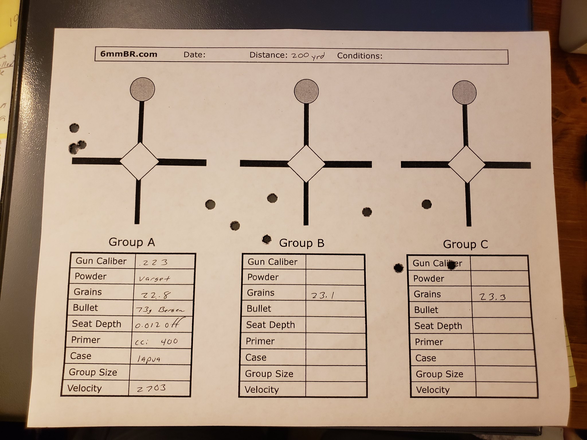

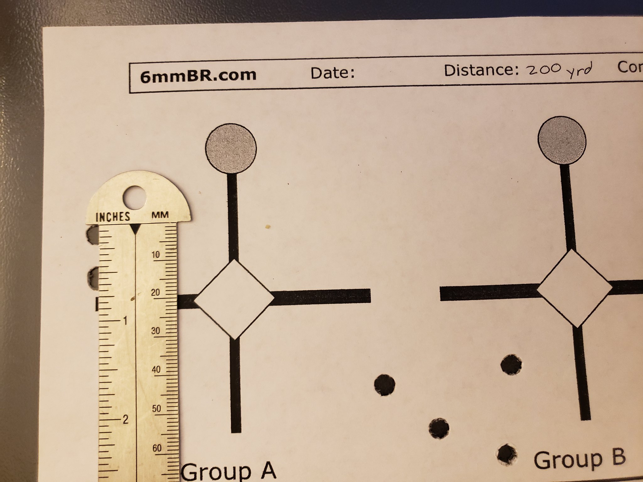

I finally go around to loading for this rifle. I just kept shooting some factory ammo with it for a bit. I did a 4 shot load development @ 200 yards with Varget and the 73gr Bergers. I am going to do a 5 shot seating depth test with the 22.8 load this week. I hope I can repeat the results.
