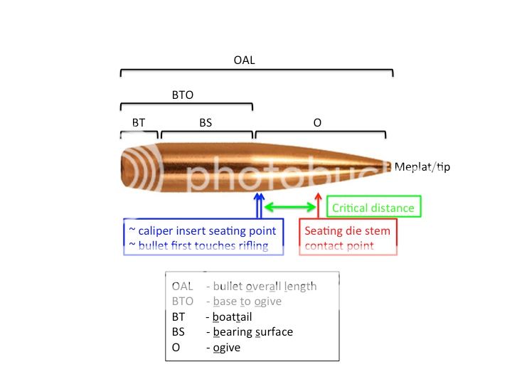

The key to uniform seating depth at any given die setting is the distance between the seater die stem contact point, and the point on the bullet ogive that first encounters the lands. The point at which the comparator insert seats on the bullet ogive is presumably close to the point that first touches the lands, but may not be exact depending on whose comparator inserts you're using and/or whether they were cut with the actual reamer used to chamber the rifle.
Nonetheless, it is possible to seat bullets with significant base-to-ogive (BTO) variance to very uniform seating depth, because the points at which the seater die stem and the caliper insert contact the bullet are outside the BTO region (see image below). Bob Green's Comparator actually sorts bullets based on the distance between these two critical contact points. The caveat to having uniform seating depth with bullets that vary markedly in BTO is that although the bullets may be seated very uniformly with respect to distance from the lands, they will not have the same length of bullet shank seated in the neck. This can affect the effective internal case volume and the amount of friction gripping the bullet in the neck, thereby theoretically also affecting bullet release, pressure, and velocity. Hopefully, the differences won't be huge, especially if you sort bullets by BTO.
But the question again is what are the limiting sources of error in your chosen shooting discipline? If even such a small difference is detectable on the target, it needs to be addressed during the reloading process. If it is way down in the noise, you'll probably never notice it. In many cases, the only way to know for sure whether some aspect of the reloading process is critical for a given discipline is simply to test it and let the target tell you whether or not it matters.
