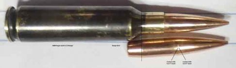

I bought a spare Hornady insert for the calibers I reload the most.
I reamed the .223 insert from the factory 0.213" hole to a 0.217" hole with a very slight chamfer, which gets me closer to a 0.219/0.224 bore. I think :)
Makes a difference on long sleek bullets.
This is the 0.213" insert Vs the 0.217" insert with a .224 Hornady 90gr A-Tip.
BTO= 0.701" Vs 0.658"
I have since marked the 0.217" insert with Aluminum Black.
