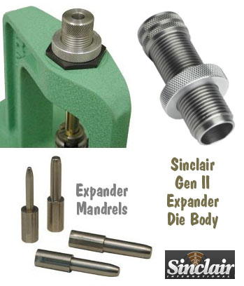

I would never use an expander ball. I use a expanding floating mandrel when mecessary

Another method is to remove the sizing dies expander and expand the case neck with a expander die. And expand the case neck on the upstroke of the ram with the case resting on its base. Cases fired in semi-autos can suffer damaged rims that can cause the case to tilt in the shell holder on the down stroke of the ram with normal dies.
