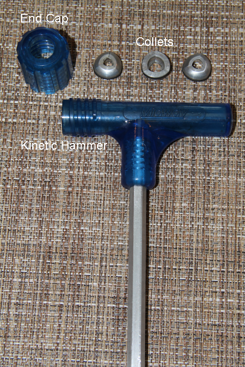

The Hammer
You should have three collets as pictured above.

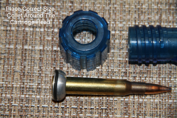

Place the collet around the case. The collet that best fits. The rubber O ring should secure it.

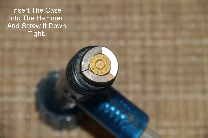

Things should look like the above picture. The collet securing the case rim.
Place the end cap on the hammer and screw it down tight!
Now take the hammer and smack a brick, concrete and anything hard! You really have to whack the thing hard and it likely will take several hits. Make sure you keep the thing straight and hit at a 90 degree angle or the things break. Since you have a kinetic bullet puller (a hammer) that's about it. The collet type are better as mentioned, a RCBS Collet Bullet Puller works real nice and you add collets for different bullets but the collet type will not do certain bullets. Wad Cutter for example and other soft lead with no place for the collet to bite.

Yea, but you have pictures Ron. But I think your picture shows the collet backwards... ???
OMG, I don't believe I did that. Note: Place the collet on correct direction! :) I actually looked at it, thought it looked a little peculiar and just took the pictures. Real bright! :) Thanks for catching that and pointing it out.
Ron
I think so also. Flats down on the hammer and radius part towards the screw down cap. At least on my RCBS from years ago.

Thank you. You were the first person to take the time, with pictures nevertheless, to explain and articulate exactly how the process works. It now makes sense. I was attempting to use the thing ass backwards.
