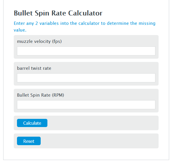

Factory 22 ARC 62gr ELD-VT show a published muzzle velocity at 3300. In a factory 7 twist that is 339428 rpm.
