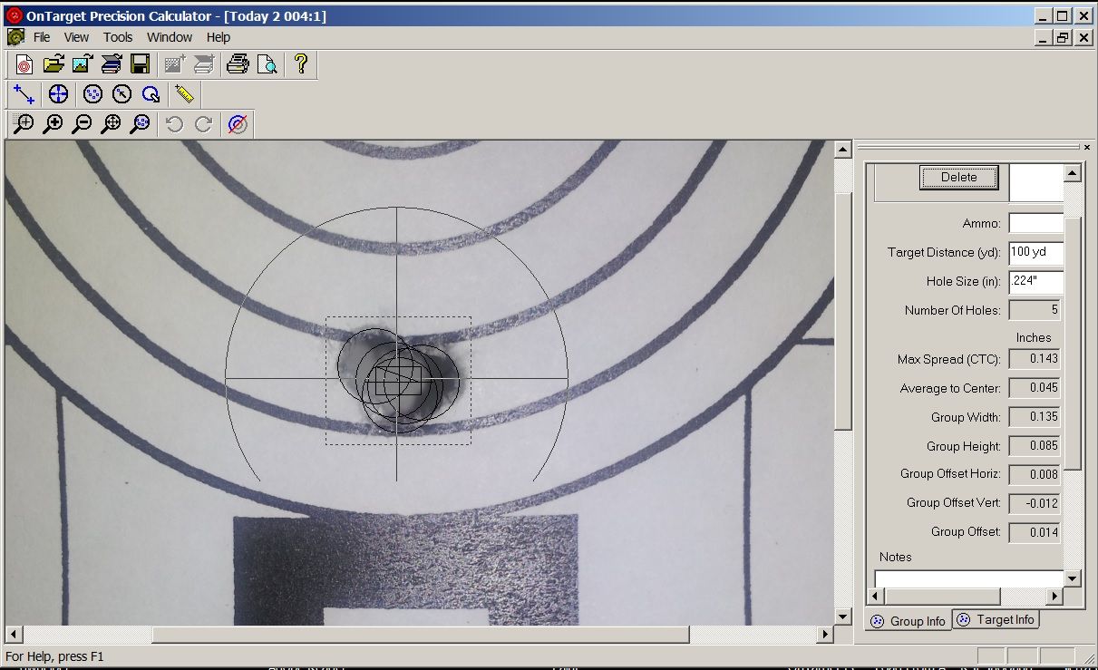

Bullets are a well known brand, 50gr, not too long for the 14" twist., and barrel is okie dokie.
Same rifle, same day...
