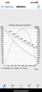

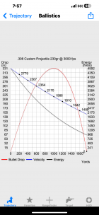

Like this?
If so, just set your zero distance at the max range you’re curios about instead of say 100 yards.
the red line looks interesting -i will look into it- when you think about it the drop the second 500 yards is much more than 1st 500 do i dont think the top of arc is at 500 but im certainly not sure— thanks
In this 1,000 yard case, apex is at 555 yards per the app, so 55.5% of the way to the target. When I do it for 1 mile shots, which is why it piqued my interest (I wanted to know how high bullet got above line of sight), the apexes are right at 1,000 yards, or 57% of the way to target. Remarkably similar.
Is this accurate? I have no way to test, nor reason to doubt. I will say the trajectories where the bullet passes 100 yards lined up with my come ups in MOA. (ie, 28 min from 100 yard zero to 1k with my 6.5x47). Same for the mile shots in these two.
i did this in shooter and it appears to be correct. i am also interested in this because i wondered about bullet height. the graphs on these phones have to compress x axis alot compared to y so the graph looks exagerated compared to wat it would actually be. the slopes would be much less. however i believe the drop/rise figures are correct. this is wat im looking for. i will try shooting some tall targets and see if i can verify at least some of these. thanks much for your help. i will let you know what i find out
