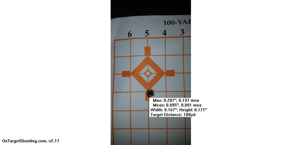

this is my little savage .005 off a hard jam with 105 hybrids. see my way works too!
