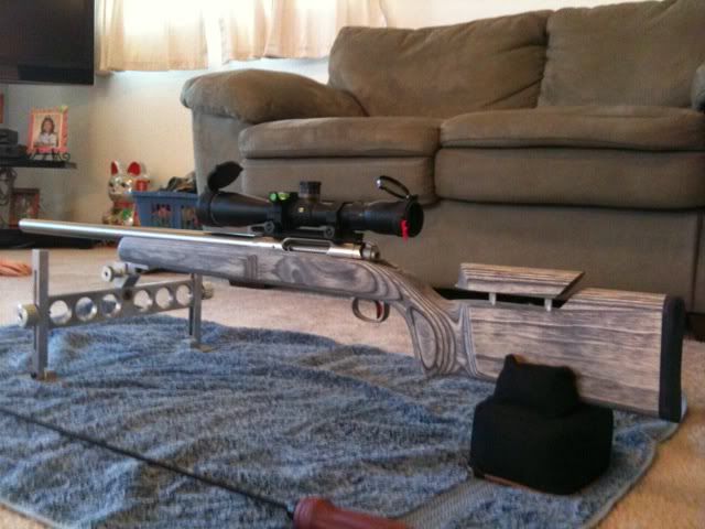

I have a 6br 30" Shilen 8 twist barrel on a Savage RBLP action that I have been playing with while waiting on a rifle to be built.
Its shooting pretty good for something I screwed together.
first five shots out of the barrel
Rich44,is that stock the factory hs precision ? That is good shooting from a not broken in yet barrel.That gun has great potential. It is also a very handsome rig as well. Keep up the good work. Now to digress,I would also go with rble as it is common sense to grab with the left and feed with the left.I wouldnt take the ejector out but cut the spring down one coil at a time till it just gives enough pressure to release it from the extractor.I have good luck with shilen and best luck with hart barrels in my 6mmbr.I have a gun scheduled to go to sid goodling for a hart upgrade to 1 in 9 in .223. If you dont mind trying another barrel instead of shilen ,give that company a try.The next thing to do is join savage shooters and get on their forums.They also have direct dealer links like Northlander Supply.He has the best barrel prices around for shilen,mcgowen,criterion(kreaigers button rifled division) and brux. He also has the remage nut and barrels for the rem 700 conversion.You are really going to like the 6mmbr as it is now my favorite cartridge. Good luck! Jon

Yes it's a HS stock off of one of the first LRPV's that action and barrel are now being bedded in a Shehane MBR Tracker.

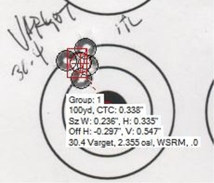

rich44 Thats a good start but you really need to get the vertical out of the load. if thats 100 yards then it will only be worse the farther out you go. I would try a bit more powder and maybe a little more neck tension and make sure your seating depth is proper. looks like your on the right path though! Dont worry about barrel brake in unless your barrel is showing signs of copper. good luck man, looks good! Lee

Group shot at 100yards during initial load workup. Less than 20 rounds down the tube. ;)

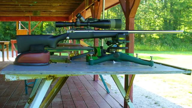

Here is my 6br. Built on a Savage Target action, Bill Shehane MBR Tracker stock and a 28" Broughton 5c 1in8 tw. As well here is a target I shot at 150yrds with the 95gr Berger hunting VLD. Under 50rnds down the tube at the time the target was shot! (5 shot group)
I have not been able to repeat this group, but have came very close! I do believe it's the nutt behind the butt, and not the rifle! I do think the rifle is capable of repeating the group just not me. (yet) Either way The Savage action is a awesome action for someone to start with or build on a budget!
