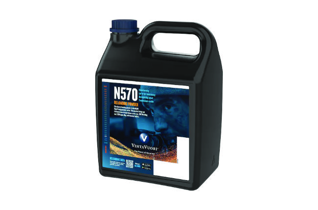

If you can find some N570

My guess is that it just does not like this powder. Seen this in several different calibers, as I am sure you have. Find the right one and all is good. It is still early. Good luck.
Paul
I concur
H1000 is better for the smaller 338’s like 338NM
Retumbo is about the fastest I would go with a lapua improved.
It might have enough capacity to make 24n41 viable.
R30 and N570 are definitely where I’d start.
N570 is really good stuff and surprisingly decent temp stability as long as you’re not getting silly with it.

Jackie, Whiddens has N570 again:

I have a jug of N570 coming, it should be here Wednesday. I also acquired 2 lbs of regular N-170.

N570 has been fantastic in my 300NM, I bet your 338 will love it.
