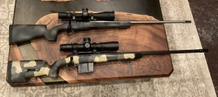

We are lucky here, you can travel 30 minutes and shoot as far as you want, no people either. Jon Beanland built me a 338 Lapua (the bottom one) years ago, Alex Wheeler built me a 300 NMI improved a couple years ago. Both have terminator brakes and are mild enough that my wife and daughters shoot them, if you have sinus issues they will clear it I might add. It’s a lot of fun to pull the trigger, wait seconds for impacts, watch the vapor trails etc etc. That Valdada on the 338 is made for that stuff, great optic. Best enjoyed with someone calling out impacts or misses, if I’m shooting solo I’ll set up the spotter and attach my phone so I can review what I did if I need to.
Your in for a treat.
