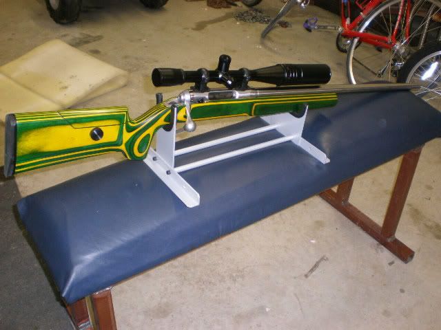

Here are two Savages I put together:
I recently decided to try the world of Savages after being a life long Remmie fan. I brought a Stevens 200 for $259. It was 270. Sold the barrel and stock on Ebay for $130 (back in the good old days). Actions was trued and timed by the SSS. It wears a Boyd's stock with pillars installed and was bedded to the action. Scope is a Burris 6-18x Fullfield with Signature rings. The trigger is a SSS. The barrel installed is a 27" Shilen chamber in a 6mm Rem (SAMMI Minimum), 1:12" for the 75 grainers. I have less than $800 in it with the gunsmith work. I did the finish work on the stock myself and installed barrels and triggers. I have more barrels for this than my wife needs to know about. All of them shoot well. Some better than others. I have a 6BR barrel for it as well, but as others said: A long action is not needed with a 6BR.

This is a different Savage put together based on a Target action. Action was trued and timed by SSS. Wears a SSS stock. This is a Krieger 6BR barrel but I have seveal others in 6BR and 30BR. It has Fred's new Evolution trigger (2 oz). Using it as a bench gun and will try FClass with it this summer. I under a $1000 in this one with the first barrel I got. Again... we want discuss total number of barrrels just in case my wife is easedropping. ;D
Absolutely love this rifle.

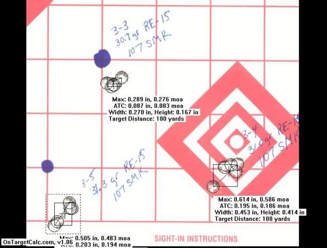

Here are some 6BR groups I shot at 200 yds doing load development with 107SMK.
They aren't BATs or any other custom. But they shoot better than my ability to read the wind at this stage in my Shooting. Plus for $300 I can try out any new caliber I want with a new pre-fit custom barrel (I am a Shilen guy). I have 223, PPC, and 308 boltfaces and can swap with all of them.
