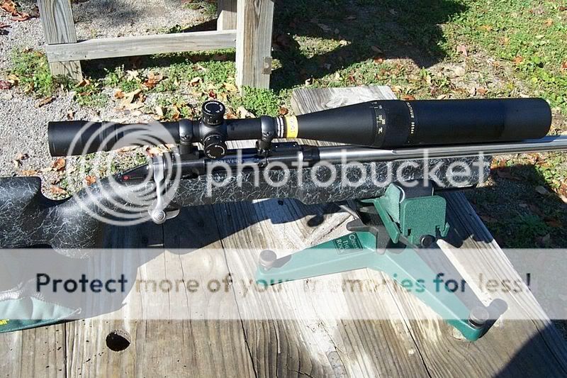

My deal is not as good as some but I think it was a deal at any rate.
I picked up a 600 Mohawk that had been molested, 700 bolt handle, Sako extractor, Shilen trigger. Rebarreled with a pencil 6mm Rem. (cal. unknow at time of purchase) stocked in bondoed up ADL. I gave $200 for it. It took me a couple years but I found a used laminated stock of my likeing for $100. In another deal I picked up a Leupold 6-24 EFR for $150 which I traded for a new Lihja 6br barrel chambered and installed. Put a EGW mount, warne rings and Pentax LS-30 6-24BP $400.
Total cost $850 for rifle that shoots under 1/2" and whales on the rock chucks in ID.
Added a pic. The rifle is currantly sporting a Sightron S-III 8-32MD, so I guess that blows the budget, it was a five year build to this point.
