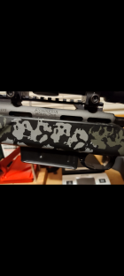

Sounds like you simply want a full custom rifle. You don't need a reason to want one. Like others here have said, a gunsmith can clean it up, true it and get it as smooth as a custom. I was hung up on a custom action also but being honest with myself, it didn't do a thing better than the Rem 700 did for me. I hunt with my rifles and play at the range with them. I'm not a competitor or have the need that some comp actions may have that I don't need. You can customize the bolts, knobs and even action body. I had my gunsmith lighten mine with side ports on the body and skeletonizing the bolt handle. Used an aluminum knob as well. I do have a Pierce, Stiller and Surgeon action. I don't see a thing different with them over my 700 actions. Attached are the skeletonizing of the action parts for a minor weight decrease.
