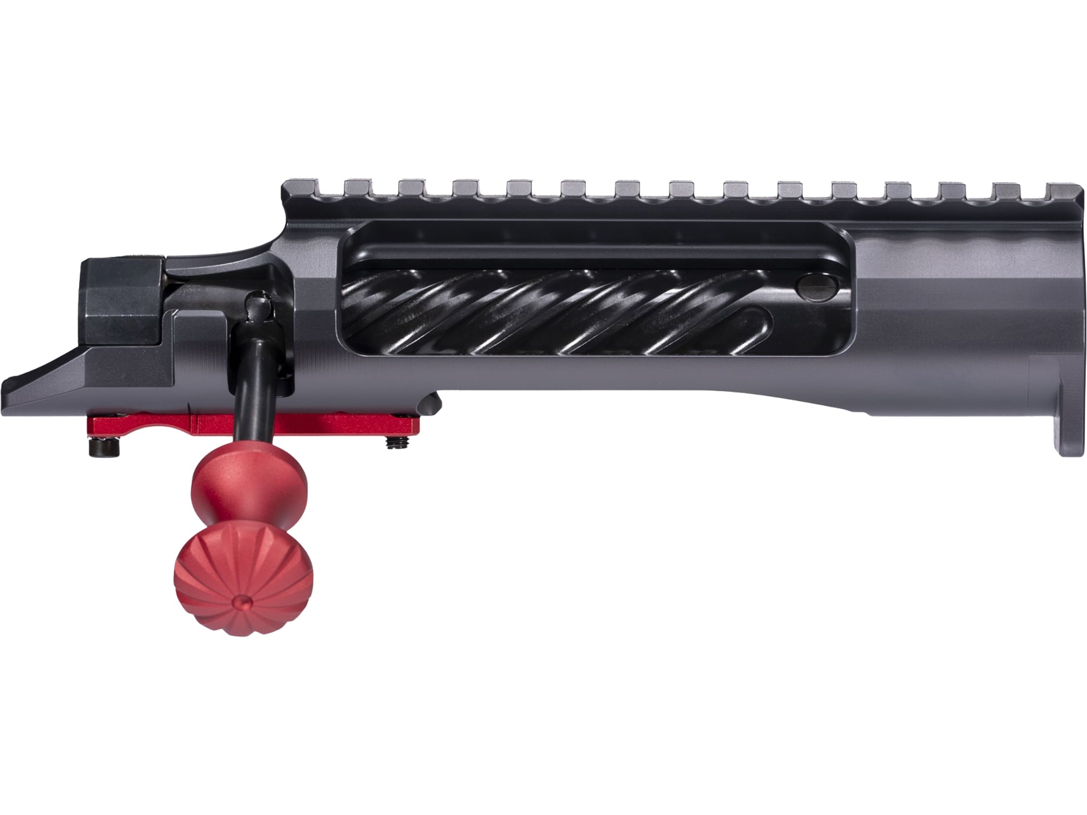

I'd also give this a serious look. It seems a run of ARC CDGs for Midway
