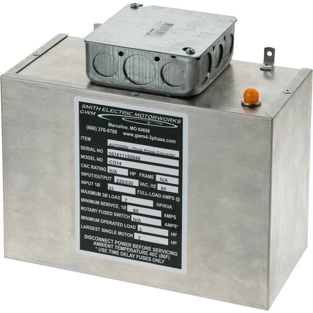

I have this on my Logan Powermatic 5 horse. Works beautifully. Never had a single issue and I run that thing hard.
Good to know! Looks nice and easy. Might have to check it out if I run into any more issues. Thank you!
They work fine unless you have more than one thing to run and you only get about 2/3 of the horsepower, I have one on my Bridgeport clone, I will most likely change it out for a vfd though. I tried the static converter on my Chinese gear head mill and it did not like it at all. It has a power up and down feature for the head and it would kind of work, The feature would only work if the spindle was turning, Once I hooked it up to the rotary I got, It worked like it should.
