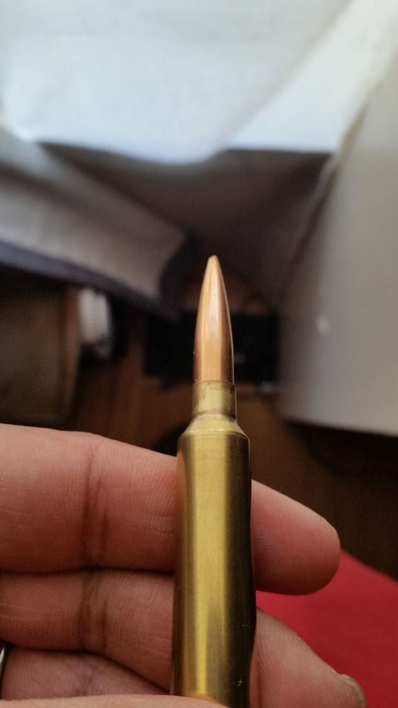

The only thing now after doing this is that I get a line where the bushing stops. I dont think this is bushing or die issue, but more of an issue that since, I have a no neck turn chamber, my neck gets blown out to a final OD of .315" and I am then resizing the brass all the way down to .311/.312.
See below for a pic. On the left side, the brass that was getting shaved a little. You can see where it was happening as it appears to be a lighter color. I was still getting the horizontal line on the brass on the left, but it was less pronounced as the shaving was masking this horizontal line. Now that I dont have the shaving issue, the line is more pronounced on the brass where I believe the bushing and the die meet. I polished the crap out of the die so there should not be a crazy edge there. I am also using redding TiN coated bushings.
Do you think this is still an issue? should I try to maybe chamfer that edge from the top side?
