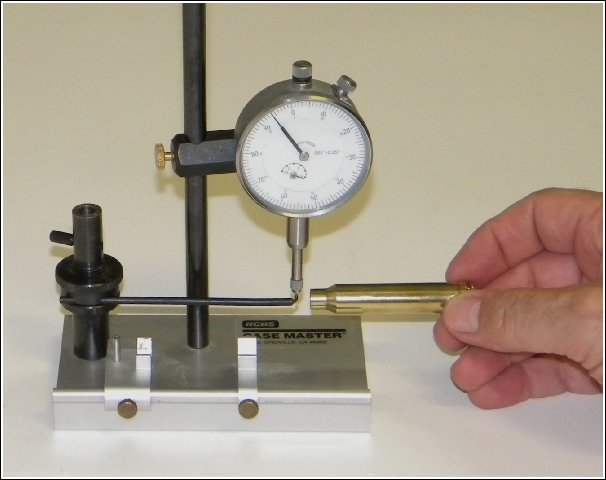

I use a RCBS case mastering gauge like below to measure case wall thickness and stretching in the base web area.
My guess is your Remington cases do not have a uniform case wall thickness. And causing uneven brass flow during sizing.
