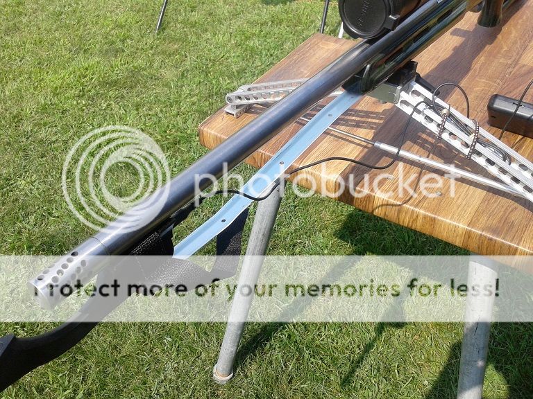

I've been shooting my MagnetoSpeed for several months now with the bayo attached to a piece of aluminum that is attached to the sling stud. I removed to rubber spacer and the strap goes around the barrel very loosely.
Nice idea, Bill. How's it work? Is that extension piece stiff enough to prevent the chrono. from bouncing around under recoil? The upward bend in it (at least that's what it looks like) about 2/3 of its length toward the muzzle makes me think it's pretty light weight material and subject to flex.
It works well. It was a piece of metal I had laying around and I can't remember what it was originally for. Using it with my 16 pound 6mm rifles with muzzle brakes has not had any recoil issues. As I said, I have the strap loose over the barrel which would keep it in position during recoil.
There are actually two bends to get the bayo lined up with the bore.
