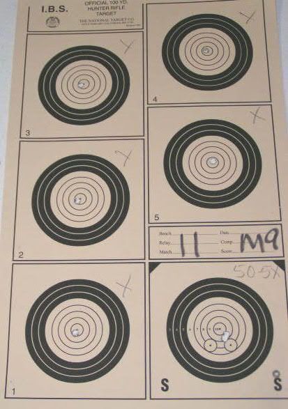

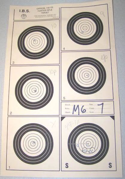

Below is a score target. At first you will be happy to shoot 10's. Then you will want to shoot X's with more regularity and predictability. There is a lot to learn so be ready for some minor disappointments and some major 'fist pump' moments.
At Saturday's match I shot clean with 2x, 3x, 5x, 5x, 5x = 20x. I was pumped after shooting three 5x targets in a row. I was still just in 2nd place at 100. The winner shot a 5x on the FIRST target and had 21x total. The lesson I learned is to have your condition identified and KNOW where the shot is going before ever firing the first record shot at 100. Shoot enough sighters before the first record shot to make it count. One low X count target makes winning almost impossible.
The above target was shot last year with my Savage 112/SSS 6BR. The target below was shot last Saturday with my Viper 30BR. Notice the BIG holes !!! This was the second of the 5x targets I shot. I shoot the record targets in the order; 5-4-1-2-3. Notice how the bullet holes in bulls 5 and 4 are in the same basic location and the same for 1, 2 and 3. I probably should have adjusted my poa for bulls 2 and 3.
ETA: Also notice on the sighter target the actual POI when holding on the dot.To hit the dot on the record targets I was holding low and about dead on in windage with maybe a little rightward correction. My condition was very light from left to right which is why I had a bit less windage correction in the POA than what is shown on the sighter. Have I confused you yet ?
