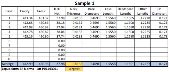

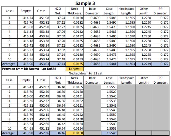

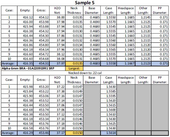

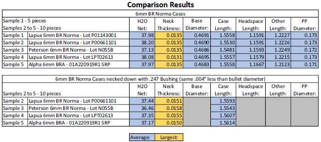

Here is what I have found with the brass I have/had on hand. A Hornady vernier ball micrometer was used to measure neck thickness. Having heard the Alpha brass was shorter in headspace than other brands, I chose to take a comparison measurement on the shoulder as close to the neck as possible. This was done by using a 28 cal bullet comparator and this is shown as "Other Length" in the pics. The samples of Alpha 6 BR brass have not arrived yet so I was unable to compare it to the BRA brass for measurements and capacity. After measurements were recorded I neck down the 10 pieces in each sample to 22 cal with a .274 bushing - maintaining the same 4 thou less than caliber that I found in the 6mm state. Between all the handling and drying, many of the markered 1-10 numbers became illegible so the positional 'numbering' for testing got mixed and doesn't correspond. Having heard Alpha primer pockets were tighter than other brass brands, I checked this as well.
Primer pockets were plugged with a 21st Century PP plug. All external measurements beyond neck thickness were down with a Mitutoyo digital caliper and weighing was done on an FX120. I used a set of (-) .001" pin gages to measure primer pockets.
Did you resize the neck in one step from ~0.267 inch to 0.247 inch? A 0.020 inch diametral reduction in one step could induce a lot of neck eccentricity.
Yes, I did this in one step.
When I built my 20x47L, I necked down ~.060 in 7 steps with bushings I had on hand. I still ended up with an average of .010+ of neck runout after running a .2031" expander mandrel through them prior to loading. The first 10 fire-forming shots went into a .389" group at 100 yds.
