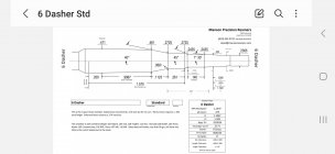

I am looking to start spec'ing a reamer for a 6 BR variant and have not yet been able to get my hand on brass to measure. Through site searches here I have found posts with mic'd thickness from over 10 years ago Blue/Brown box Lapua. What I am asking for here is some more recent measurements based on the following for Lapua, Alpha and Peterson brass measured with a tube or ball micrometer:

My thought for what it is worth is you need your "variant" case WITH the bullet you are going to use, seat the bullet and get that measurement to get a true "loaded round" diameter THEN spec your reamer. JMHO

I do understand what you are saying completely. If I only had some brass to do this with! I haven't found a source the has Lapua brand available at this time. I got off the phone less than an hour ago with Alpha and I have a sample of their brass coming. I will contact Peterson Monday for the same.
Once I have this in hand, I can get a 'true load round' number.
My unturned Lapua 6br brass necks avg at .0126 Lot # PO1188206/1261919. What I done when I had Manson do me a reamer was to get the brass first then measure. Safest way to go and get enough of the same lot to run the life of your barrel. JMO

Thank you for the input numbers. They are right in line with those I have received from other's regarding Lapua 6BR brass with the Lot # beginning with "P".
I'm within 30 miles of Manson and I spoke with them earlier today. Ray is back from S. Africa and should be back in the shop on Monday. I expressed to Blake I'd hold off on sending them my preliminary hard numbers until I got the neck numbers sorted to save everyone's time.
