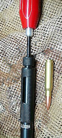

The Sinclair Delrin guides aren't bad, but they let your cleaning rod bow more than is desireable. The Lucas guides have a insert in the rear that provides a tighter clearance on the rod, keeping it centered in the bore.

On this page you'll find pictures of the Lucas guide, along with a product review:
http://www.6mmbr.com/catalog/item/1433308/954882.htm
The Lucas is made from the same material BTW, just in black. I've never used a Lucas, so I don't know what the fit to the rod is, but I have made my own. With the right reamers for the rear insert, I have less than .005" total clearance for both my small and large Dewey rods. You can really see how straight the rods travel down the bore when cleaning.

Being caliber and rod specific is one of the benefits of the Lucas guide, and that's why they work so good.

I like the Lucas guide, that's what I use. Another issue is rod diameter, that's one of the reasons I prefer Bore Tech rods which are more caliber specific. This really comes into play in the longer lengths needed for 28inch + barrels with bore guides and solvent ports and high combed stocks where you need a 54 inch or more rod. Those 22 caliber rods become awfully "whippy" at those lengths.
