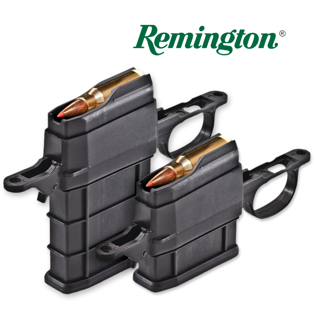

Thank You for the reply. I guess my question should be, will a detachable magazine "bottom metal" fit into a BDL inletted stock ?

Thank You RussellJ. I emailed Jim Borden for his opinion on what is my best option. I didn't purchase the McMillan Hunter Edge stock as of yet, and it might not be the right choice for the SS6 action with a 6BR chambering. I'm wanting to build an ultra-lightweight coyote/whitetail hunting rifle chambered in 6BR & just trying to figure out the right parts to buy.
Kwik klip also do a HS precision style bottom metal that is a drop in fit for a BDL inlet.
