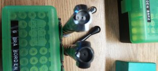

My Borden actions use his hook extractor. They work great. All else is the same for the location of the port.
How is tension held down on the extractor so it will snap over the case rim?
I haven't taken the extractor apart, but it is a spring that keeps tension; I imagine probably a leaf given the packaging constraints. The assembly is all in a bore in the rim that does not break through to the outside of the bolt - all contained. When I have the gun out again I'll snap a couple pictures for you.
The extractor is long with a skinney middle - which is bent just enough to capure the case - it is held in place with a roll pin at the bottom. Then extractor is 1 to 1 1/2 inch long.

Jackie, Sorry the photos are a little blurry. Hope they may help a little. I have two BRM drop ports and really love them, cases drop straight down onto a small terry cloth towel, don't have to worry about them rolling off the bench onto the concrete and getting dinged up. Also helped me increase my speed, I shoot 1000 yds. at Williamsport. Been shooting them 2 seasons and have never had one not extract, also like the idea of not having any side pressure on the case while in the chamber. If you use the wheeler method of finding your touch point, no ejector to remove. If I ever figure out how to post a video, I would extract a couple to let you see how it functions. Hope this may help a little.
