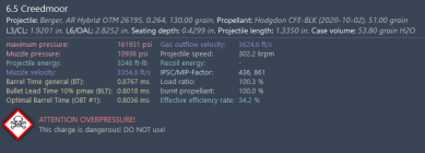

This is a perfect example of how not to measure bolt thrust or excessive pressure. Know your signs of excessive pressure by measuring head diameter from the beginning with new brass. Find what is maximum for your rifle, .0008" head expansion is maximum! When you get to hard bolt lift you have gone past max and you are not going to save that brass without a considerable amount of needless work. Go to Hornady website for a clear explanation of how to measure excessive pressure. Sorry that is the Hodgdon web.site
I forget who did some test on what we deemed pressure signs. They used one of the epoxy on strain gauges. The “signs” many believed to be start of high pressure were way higher than what was always believed.
Then there were no constants. Pressures were through the roof, bolt lift was normal brass showed no visible signs or measurable signs of pressure.
I have been bashed on this subject before. By gosh and by golly attitude towards what we guess as pressure is just that a guess, no more no less. Unless there is some piece of equipment hooked to your rig for measuring pressure, it’s just a guess.
Look at the 280AI. When it was a wildcat it did some amazing unheard of things, all with “no pressure signs”. So for years it was deemed safe and many folks used it with no ill effects. Fast forward a number of years and it was legitimized. But to get it to pass SAMMI spec it had its “teeth pulled” and does little over its parent cartridge.
