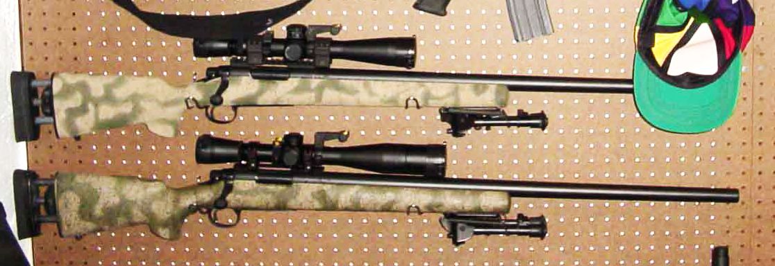

I built two M-24 Clones, a 308 repeater, and a 300 Win Mag single shot. Built the 308 first for the Carlos Hathcock matches, and our team got our clocks cleaned by a Swedish team with 300-WMs
So I built the 300-WM. There was no disadvantage using a single shot. There was a BIG advantage with the 300-WM on the 1200 meter "E" targets.
