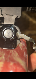

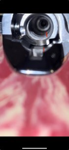

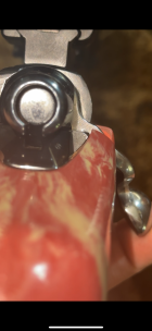

I’ve been going over this gun while I wait for some components and I just now noticed this.
I have attached pictures of the bolt fully closed out of the stock, in the stock, and open.
Based on feel the lugs of the bolts are fully engaged in the action and when it is sitting in the stock it just lifts the bolt enough to take away some of the slop before you open the bolt.
I have not fired this gun yet, I was told there was around 350 rounds through the barrel and its current configuration.
Is it safe to fire it like this or do I need to break the Dremel out and start removing some stock?IMG_5038.pngIMG_5039.pngIMG_5040.png

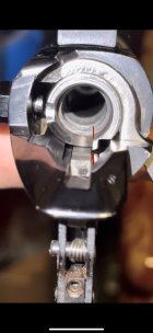

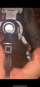

So after looking at it this way I’m going to make the call not to shoot it in this current configuration. From what I can tell the bolt is hitting the channel cut in the stock for the bolt, but the problem with that is being a dog leg bolt if I make that deeper I’m going to have to cut into the side of the stock as well so it’s not touching there.
I reached out to Dan at ACCU-Tig, waiting to hear back. The plan is to have a new straight bolt put on and open up the stock as needed from there.
