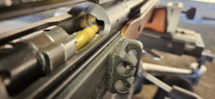

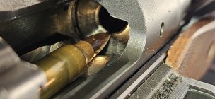

Anyone running a Bob Sled 223 AI (loading long) successfully?
On my MDT chassis (no mag adjustment) my 2.482" COAL rounds are a no go. The ramp dosent raise the round high enough.
Shorter COAL rounds work AOK though.
69s.. ok
80.5.. not so good, lol

I have the same setup, bobsled does not work. So I use a 308 mag in mine and it works great.
Ok... so I had 2 metal 308 MDT mags. Probably rebranded Accurate..
Anyways they worked somewhat. I had to fiddle around with where I placed the round. Honestly it was just as easy to load them into the chamber.
I modified one to where it has a 223 slot deep into the top. It looks like a 223 sized canoe. The round has to pop the nose up significantly for an Ackley
