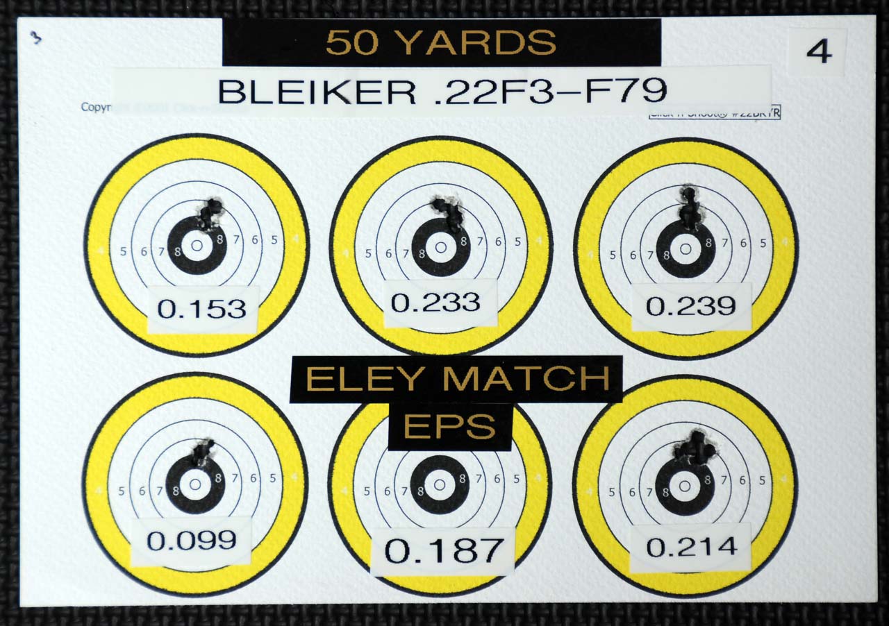

Bleiker groups reports - Inaccurate?
Look at these groups with the reported c-t-c sizes.
http://www.accuratereloading.com/2009/bl50.html
http://www.accuratereloading.com/2009/bl100.html
I cry foul!!!
I think the groups are quite a bit larger than reported.
:o Your ideas?
What is the diameter of the center bull? I see what you mean, though. If each hole is .221 or so in diameter, the measurements taken are way off.
The results posted were predicated on group size. Clearly, something ain't right.
I understand relative group size when measured against each other to show which ammo performed better than others, but the actual size would be more helpful if redone,

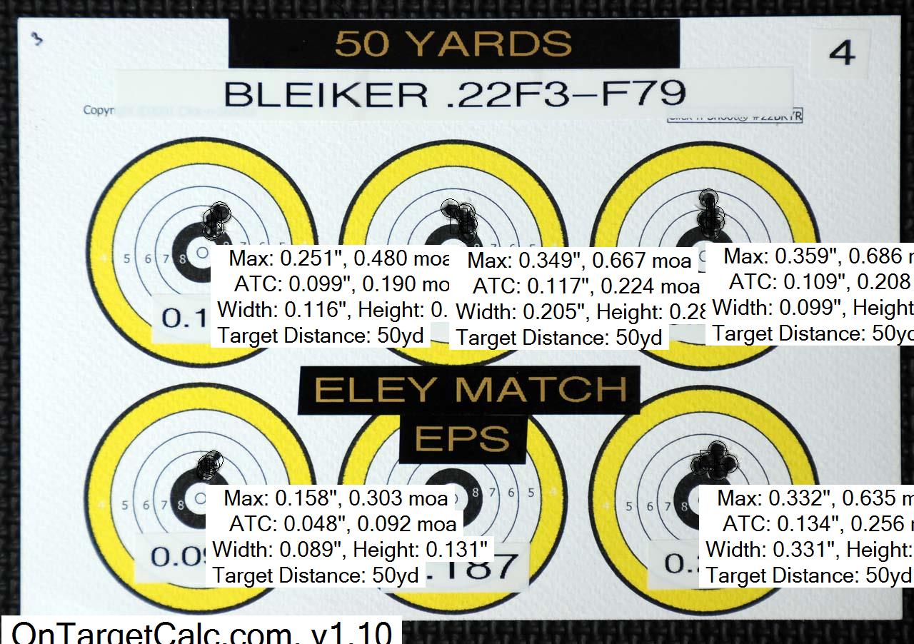

OK so I grabbed one of the images, calibrated it in On Target assuming 0.22 for a distance from the edge to edge on a clean mark on the target and plotted the 5 groups, and they do look to be very far from what they are advertised to be.
I'm going to venture a guess that his 50 yard MOA calcs were done forgetting to account for his distance being only 50 yards. If you take into acct some less than perfect measuring it makes sense. I haven't run the 100 yard groups to see.
