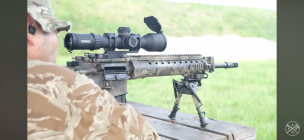

It could be. Here is the first picture I found. Just wonder what they are and any advantages ? I have shot Harris bipods that swivel/tilt left and right never been super wild about having to load bipods but if I don’t man they bounce on hard surfaces
That Harris has had a picatinny quick release and a tilt (pod loc) lock mechanism added.
The original tilt lock was made by Terry Cross which is the KMW PodLoc and a common picatinny QR is made by American Defense. Your picture looks like it’s equipped with an American Defense QR. No idea who’s tilt lock that is.
This is a Harris with a KMW Pod Loc and an AD QR
