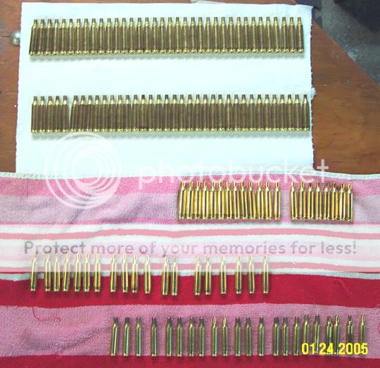

I use extremely hot water to do my last rinse and then dump the casings on an old, thick bath towel. I shake each casing with a quick snap of my wrist trying to force any residual water out of the casing. Then I shake them in the bath towel trying to get as much water out of them as I can. Next I put them on another old dry towel and get them lined up with all the casing mouths pointed in one direction. I hold the casings down on the towel with a very thick yard stick and use an old hair dryer and blow hot air into the mouth of the casings. If you don't hold the casings down with the yard stick they will blow off the towel. I also blow air into the casings from the primer end as well. When I am reasonably certain they are pretty dry inside, I let them lay on the towel for about a day and then I'm ready to anneal them. Here's a batch of brass on a towel with the yard stick I use to hold them down.
Here's another photo of a finished batch on white paper towels and another batch ready to dry with the hair dryer:
