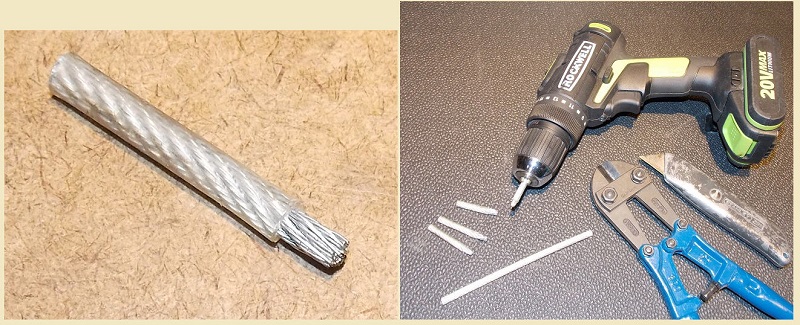

Best method, SS pin tumbling - gets them about as clean as you can get. You can make your own wire brushes out of coated cable. As the cable wears out, clip it off & start over.
