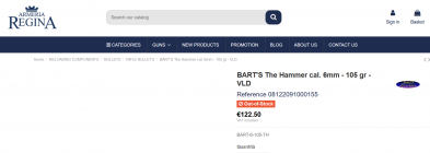

I will try Berger 105 hybrid if I live long enough to have them available.
I also would like to try Barts in various weights but my understanding is they are only available by the Thousand?

Berger 105 hybrids @ PV

No you don’t have to buy a 1000.
Bart
