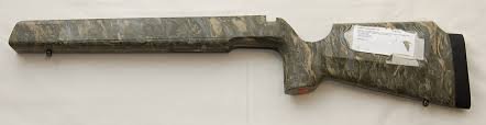

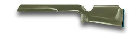

McMillan has a newer M-T Hunter that Mark Pharr (silhouette shooter/gunsmith) helped design. It is more of a cross between a hunting and full blown silhouette stock with a slightly lower comb silhouette stock, but it is only flat top and you need to ask about it.

I don't currently shoot Silhouette but moving from a Brown Precision Silhouette to a Pharr Silhouette stock was worth around four to five extra animals per 40 shot bank it was that good. That was smallbore with an Anschutz 1712. Just made the rifle so much easier to shoot.

Evelio macdonald also has a line of stocks he offers. Not sure what all inlets he can do but i got one for a 54ms and it added animals on my tally. Its like it has a built in rest

These two stocks would be my entries for desirable silhouette off hand stocks. Solid black walnut, with deep perch bellies (NRA legal palm rests!), 29" OAL, adjustable LOPs down to 9", high cheek pieces with 6-degree castoffs off the butt toe. In-letted for post-64 Model 70s. Whittled them out for my body conformation for use in NRA HP.
Patterned off a Cloward "perch belly" prone stock.
