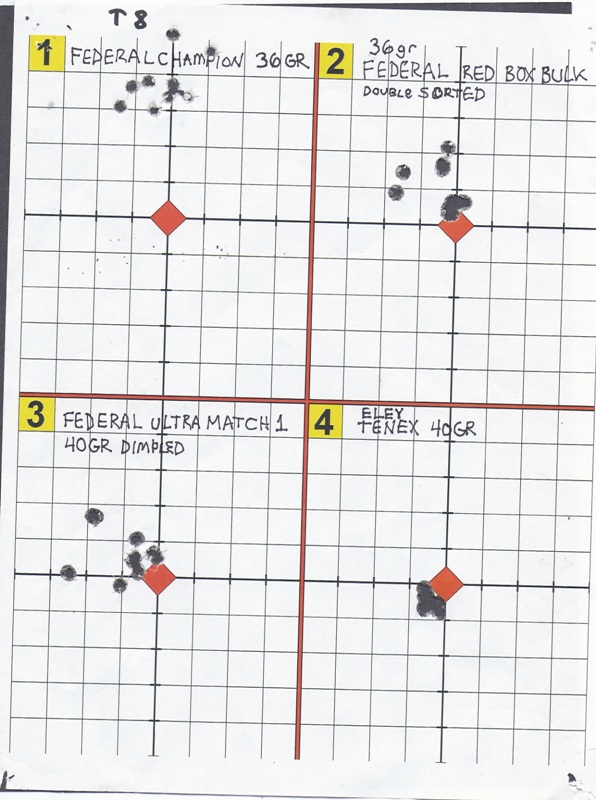

Before realizing that I had to drop a significantly greater amount of money to compete in our local ARA league, I bought a MK II BTVS from the LGS. In a thread describing vetting about 20 kinds of ammo or it, I was truly impressed with how well it shot at 50yd, with some brands of ammo. You've got to put those shots into a small spot at 50yds before taking it out to further distances, needless to say.
Here are two 4-up targets showing what 10 shots at 50yds can do. In the case of the MK II that I bought, it shot SK+ almost as well as Eley Tenex. Both ends of the serious shooting ammo spectrum.
Seriously consider the MK II BV or BTVS for you F-class practice! They offer a great degree of performance for someone on a budget.

I think equally critical is to consider the SK Standard Plus and Tenex. They seem to make all rifles a little better.
Nice targets.
