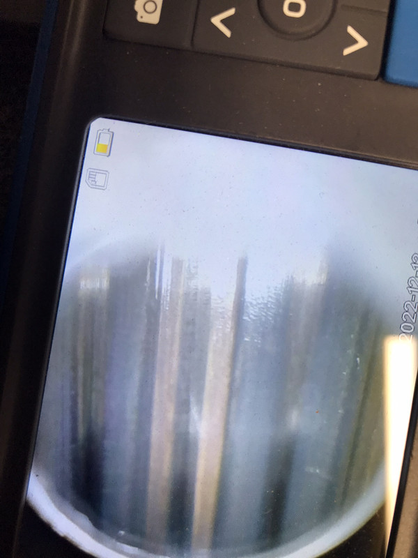

First picture 357 rifle with 100 plus rounds from a match last weekend, about a inch after the leade.

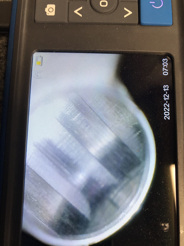

Second picture after cleaning.

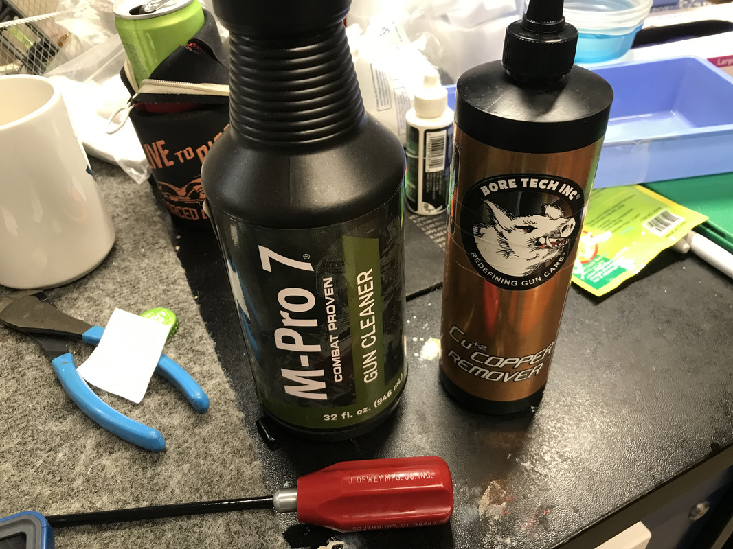

Couple wet patches with Kroil to get loose stuff, then saturate with Mpro and let set for 15-20 minutes, 5-10 strokes with a good bronze brush, dry patch, saturate with Bore tech, let sit for 15-20 minutes, wet patch with Bore tech till almost no trace (2 -3 patches) dry patch. Pics were for a friend to show him my cleaning regiment.
I don't go for 100% because I am lazy, the rifle will be dirty after the first shot and I don't shoot benchrest, depending on the game 2 MOA to sub MOA is just fine.
All that to say, medium tension patch on jag and you will have no idea how clean it is without a bore scope.
