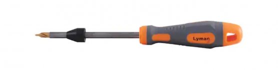

What is the best flash hole debur tool? The clincher is I don’t want to shave the actual flash hole, just the burrs. Small primer lapua brass .059 and don’t want to expand them.

I use an extra length #1 center drill in a hand chuck. Just want to remove the inner burr that the punch process makes while forming the flash hole. I'm a machinist by trade and do not like burrs. :)

The K&M with the positive stop at the cutting edge has served me well, and differing lengths or even cartridges is not a problem.
If you turn by hand, you can feel the burr. Kind of lets you know if you’re making a difference.
I use a K&M flash hole uniform tool. It does open the flash hole from what Lapua says is .059" to .062". The tool also cuts a chamfer on the inside. For me, this is a one time deal. On subsequent reloads I use the same tool to remove any carbon that might be an obstruction with a quick turn or 2 of the tool.
