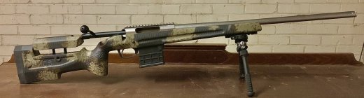

2F73DCA5-10C9-47F9-927D-37478CFAB289.jpegI do suggest GRS, there is laminate and synthetic stocks for T3. Berserk is very popular here in Finland. Here is my T3 with GRS Sporter laminate stock.
KRG Bravo is also quite popular, but usually you see Tikka with Berserk stock(if stock has been changed)
