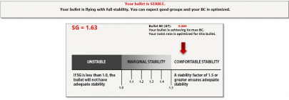

Aye. I knew it'd stabilize.. but is it... any good? Is the BR case enough boiler room to get that weight bullet doing something useful to a couple hundred yards?
Not in my view, but folks have certainly played with these and got them to group in a 30 BR.

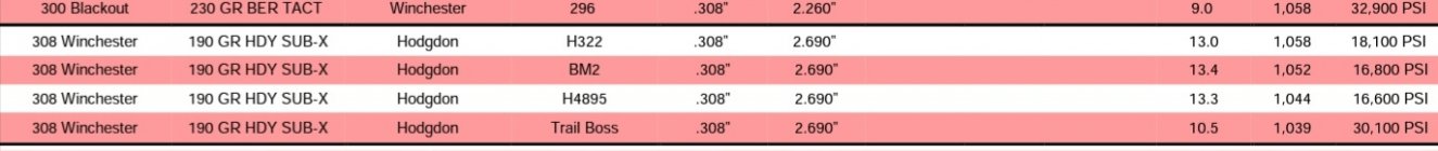

At roughly 58.5kPSI it pushes the 125 grain weight rounds to roughly 2750 fps which makes roughly 2100 ft*lbs.
For the 165 - 168 gr weight class, that means it only pushes around 2375 fps.
You would be more competitive with high quality match bullets in that 110 to 125 gr range, but it can push heavier bullets.
If you have run a 308 WIN, you have a feel for what that does with 40 something grains, and the 30 BR is around 10 grains less capacity.
Just about anything will be 'useful' out to 200 yards. But what happened to low recoil subsonic loads? I think the BR would be better suited for subsonic than the 308.
Not enough boiler room and then you'll have to move to a slow burn rate powder that may not provide good extreme spreads. 30 BR good up to 125-130 grain. 308 better cartridge for short 10-11 twist barrel.
